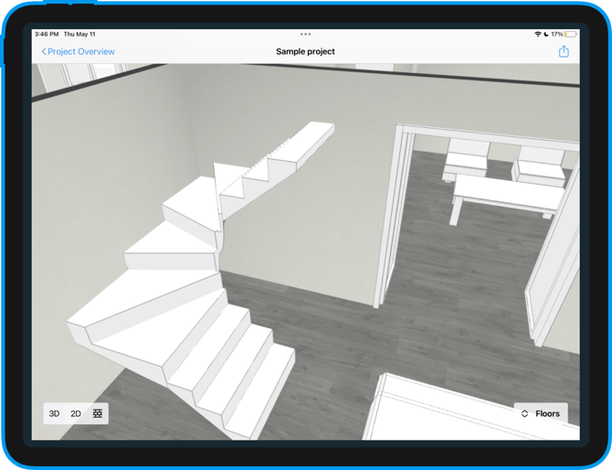

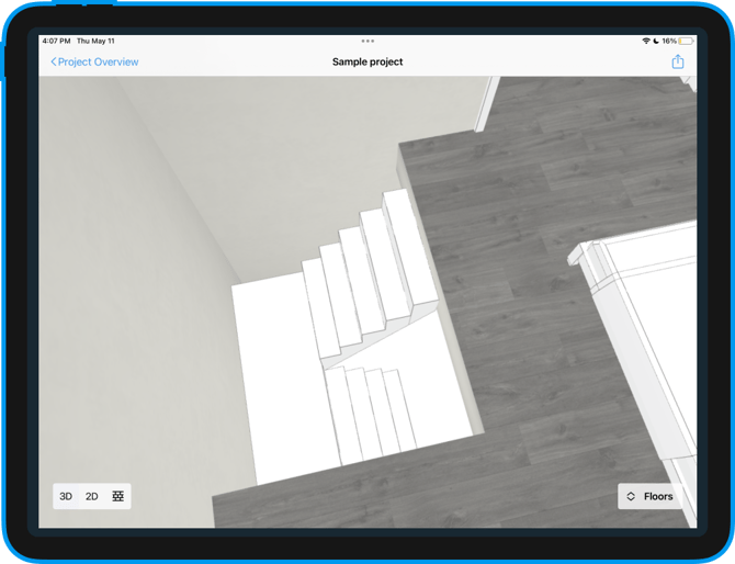

  • Corner Landing - select if the staircase corner has steps or a flat landing. Available for L-Shaped, U-Shaped, and Round U-Shaped Staircase objects.
with steps
Corner landing with stairs (3D view)
with landing
Flat corner landing (3D view)

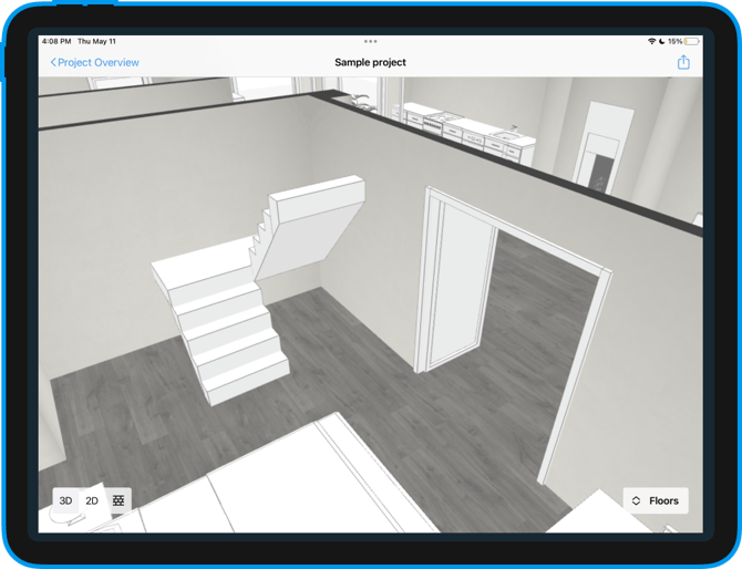

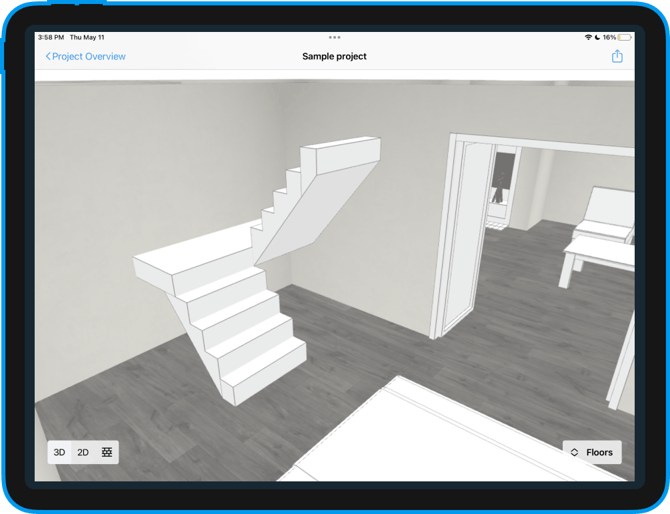

  • Leads to - select whether the staircase leads to the upper or lower floor. This attribute will change the 3D rendering; the upper floor will display the staircase going up to the ceiling, and the lower floor will display the staircase going down from the floor. Available for L-Shaped, U-Shaped, Round U-Shaped, and Spiral Staircase objects.
upper Stairs leading to upper floor (3D view)
lowerStairs leading to lower floor (3D view)

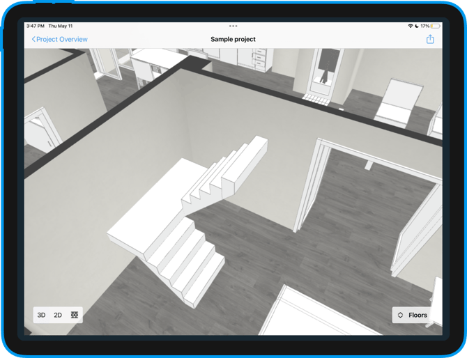

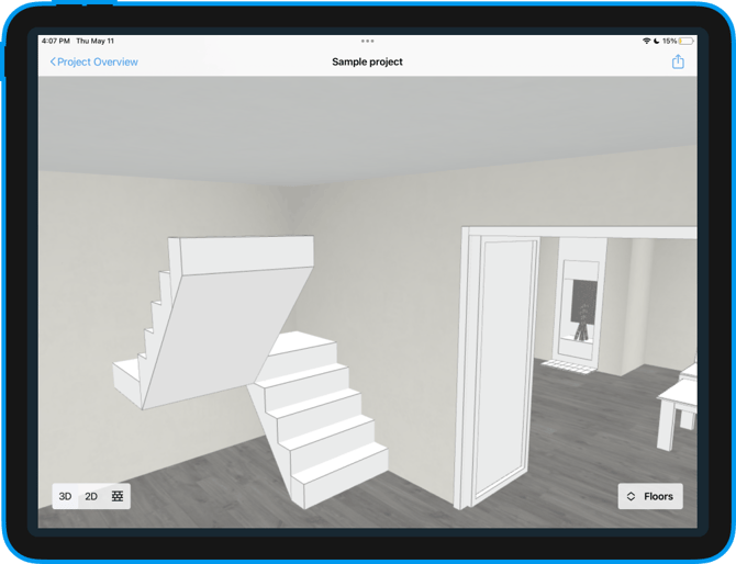

  • Up Arrow - gives you the option to show the direction to go up the staircase. Available for  L-Shaped, U-Shaped, and Round U-Shaped Staircase objects.
arrow 1
Left up arrow (3D view)
arrow 2
Right up arrow (3D view)
