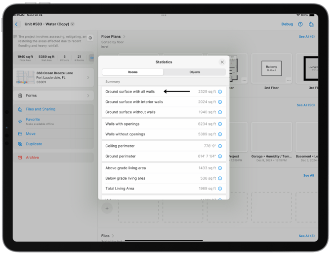

### Living Area vs. Ground Surface Area
When you open the [Statistics Summary](https://help.magicplan.app/add-details-to-your-project-floors-rooms-and-objects#:~:text=Dashboard%20menu%20features%3A-,Statistics%3A,-Access%20your%20project%E2%80%99s) of your floor plan, you will find information about the calculated living area as well as the ground surface area. It is important to understand the distinction between how living area and ground surface area are calculated.
💡Tip: When viewing your project statistics in the app, tap the "i" icon to see a definition of how that statistic is calculated.
- **Living area** = the percentage of each room indicated in the “Living Area Calculation” setting.
  *i.e. Living area = Kitchen 100% + Balcony 50% *
- **Ground surface area** = the total area or sum of all rooms, regardless of whether it is considered living space.
![statistics (ground surface with walls)](https://help.magicplan.app/hs-fs/hubfs/Updated%20HC%20Visuals%20(2025)/statistics%20(ground%20surface%20with%20walls).png?width=670&height=519&name=statistics%20(ground%20surface%20with%20walls).png)
ℹ️ **Note:** If you choose to [export your project](https://6852598.hs-sites.com/knowledge/export-your-projects) as a Report PDF, the ground surface area (Total Area) and calculated living area will be included.
