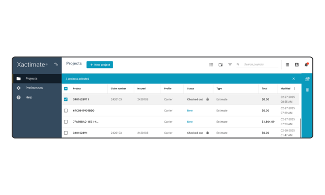

1. Go to Xactimate® Online and log into your account.
2. Click **"New project."**
   **![xactimate 1](https://help.magicplan.app/hs-fs/hubfs/Updated%20HC%20Visuals%20(2025)/xactimate%201.png?width=670&height=402&name=xactimate%201.png)**

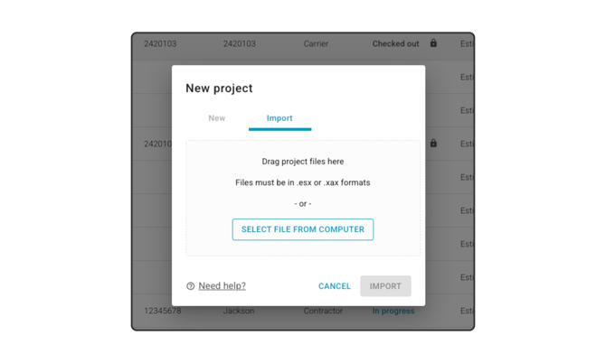

3. In the "New project" window, select the **"Import"** tab.
   ![xactimate 2](https://help.magicplan.app/hs-fs/hubfs/Updated%20HC%20Visuals%20(2025)/xactimate%202.png?width=670&height=402&name=xactimate%202.png)
4. Drag and drop your ESX file into the window, or click **"select file from computer"** to browse and upload the file, then click "Import."
5. Once uploaded, the project will be created automatically from the imported ESX.

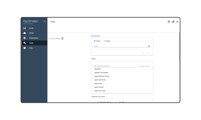

2. From the left-hand menu, select **"Tools."**
3. In the "Data Transfer" section, select **"Import."**
   **![xactimate 4](https://help.magicplan.app/hs-fs/hubfs/Updated%20HC%20Visuals%20(2025)/xactimate%204.png?width=644&height=386&name=xactimate%204.png)**
4. Directly below the "Import" option is the "Location" box. Click the **folder icon** to browse your computer and locate your ESX file.
